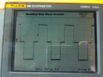

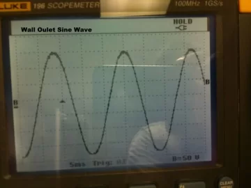

Thought I would throw these out as a visual reference. First is 120VAC from a wall outlet showing a standard sine wave. Second is from a "modified sine wave" inverter. When I get some time tomorrow, I will fire the genny, put a load on it, and put the o-scope on it.
awesome , thank you :)
X2 Very nice of you to post it!

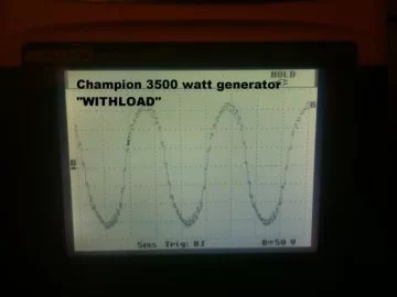

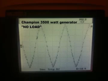

Couldn't wait till tomorrow!! Generator is a TSC Champion 3500watt run 4000 watt surge "import special"!!
*** I HAVE NOT run my stove with this generator yet *** (though I did test my three back-up motors on it and all worked fine. not sure how the triacs on the control board would react!!)
First shot is running with NO LOAD and second shot is WITH A LOAD. The load I used was a benchtop size drill press. (it was handy and already plugged in to the power strip I used)
I will try and "borrow" a 120/120 isolation transformer from work tomorrow and see if it helps clean up the noise on the waveform.

nice , my gennie's the same . heading to amazom to get the new probes i need for my old tek 453 so i can join the conversation :)
