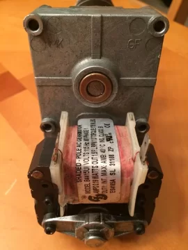

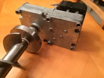

We gotta NPS45 with a messed up auger. The other morning woke up to it screeching like it was jammed. Took it out, put back in no jam. Took the auger apart and it will spin all gears fine till you hook it back up. Wont spin nothing put back together or installed back in stove. Anywhere I can take it to be reworked?

A lot of the innards of the gear reduction boxes are plastic. Taken several apart as corn burning stove owners always think thier corn is so clean.
Probably toast.
