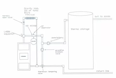

Thanks for the interest. For some more information, the econoburn control runs the the bypass circulator until the aquastat reaches 150. After that this pump is shutoff and then the primary circulator is enabled. The installation manual calls for the mixing valve to protect the boiler from cold water slugs which entering the boiler and causing thermal shock. However, it seems the mixing valve with a single (primary) circulator should be adequate. The recommended near boiler plumbing seems unecssarily complex. I am thinking of trying to eliminate the bypass pump. The recommended piping configuration provided from econoburn is shown below:

I suppose that explains the reason for both the pump and the mixing valve. It seems the bypass pump only runs at start-up, My bypass pump will run any time the return temp
drops. I am not sure but the bypass pump may be to eliminate "hot spots" in the boiler until the primary pump comes on.
I start my bypass pump when the stack temp rises above 200 degrees and then it varies depending on return temps. My main pump starts when the boiler reaches 160.
I just talked to Mark at Econoburn today. I had the same question. He said if you are setting up with storage to use a mixing valve and you did not need the pump they included. He said pump can be used elsewhere in your system but is included for people not using storage.
I didn't get that drawing from econoburn that you posted. Seems odd to return water to boiler only and not storage. Wouldn't that cool boiler down to storage temp if fire is not going?
gg
That is just a terrible design for piping to storage...
cold return water from the zones actually gets put back into the top of the storage tank, screwing up stratification. Yikes. And there is absolutely no need for the near boiler circulator when using the termovar.
The bypass circulator control is intended to do the same thing as a termovar... to temper return water by circulating out of the boiler and right back into the boiler below 150... but because of where they place (or at least used to place the thermocouple) cold water can shock the back of the boiler for several minutes before a temperature change is registered. The termovar offers a much smoother operation, and true return water protection...

Based on the description of the Econoburn controls, the bypass circulator operates until the aquastat reaches a setpoint of 150. If the bypass circulator is removed the controls need to be change to only use the primary circulator. I am sure this can be done - did Mark tell you how this can be done? As you are probably aware these mixing valves can be expensive - especially for the pipe sizes of 1-1/2" so I want to make sure I don't buy a valve unecessarily.
Concerning the diagram, this one of two schematics Dale at econoburn provided - the other without storage. For this mechanization, you are correcct, the boiler will cooldown with the thermal storage temperature. In addition, it is not setup for reverse flow in the case where youre tanks are thermaly stratified.

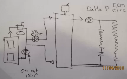

I have my EKO connected to 500 gallons piped and controlled this way. I used the least expensive solar controller with a VS and thermostatic function to drive this and it included some basic data logging as well as digital readout, hour meter, etc as part of the control.

in hot water said:
Consider using pumps with variable speed control. This is maybe the most efficient and most accurate way to mix and provide return protection. Three way mixing valves or devices are parasitic devices. They use some, maybe a lot, depending on the Cv rating, of the circ energy to overcome the resistance thru then.
By using circs, better yet ECM type circs you move the energy with the least amount of electrical energy consumption and leverage the accuracy of a thermistor instead of a wax cartridge for temperature modulation.
Yes, this may be a bit more $$ on the front end but the energy savings over the next 20 years coupled with the control-ability make this an attractive option.
hr
I just ran the calculation for a Danfoss mixinvg valve with a CV of 20. The head loss at 13 lpm is over 5ft. This is quite high considering the head loss in the piping is 2ft for this flow. Your recommendation makes sense. I was looking at a variable speed pump for the house zones but the economics did not make sense to justify. However if I can eliminate a $100-200 valve it likely will. I will consider your ides. Thank you.
If a system uses an un-pressurized boiler, or an un-pressurized storage then a HX could be introduced. This could be a coil in a tank like Tom builds, or the plate type shown here.
So the vs function could double as the return protection and the energy transfer. A solar controller with 2 outputs could run both circ shown here and perhaps fire the auxiliary heat source.

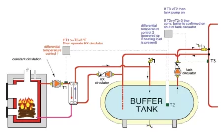

  • [Hearth.com] Why a bypass circulator and Mixing Valve for Econoburn?

That looks very close to my setup. Except my "Tank Circulator" draws directly from th HX Input where it is a T. That way when the tank is cold and you are firing up it will take the flow directly from (driven by) the HX Circulator that is HOT strait to the zones. When the HX cirulator is off the Head is higher through the HX/Pump so the zones are fed strait from the tank. Seems to be working well , the house heat load will be satisfied first then the tank no extra valves or pumps or tank ports just a T.

I like this approach. Did you have to modify the EKO controls to make this work or do the controls only shut the pump on and off? The Econoburn controls the bypass circulator and primary circulator sequentially using relay - I think I could rewire the relay to control just the primary ciruclator to work all the time. If so this option your configuration could work for me.

No one should use that drawing... it's just wrong for thermal storage. That's not even a good way to pipe a large buffer tank.
To be honest, I don't think you really even need circulation through the boiler below 150... water will move throughout the vessel via convection until the vessel hits 150 and the circulator turns on. This is how some of the european gasifiers operate, including the Froling FHG. I would not set up an econoburn like that, however, unless they provided a written addendum to your warranty that approves the design.
According to what the Tech team at Tarm says, the pressure drop across an 1 1/4" termovar mixing valve is negligible, so plumbing an 1 1/4" valve into an 1 1/2" system will be fine. You also have to consider, that your storage will be running a pretty good sized delta T most of the time... you might be sending 165 or 170° water to the top of the tank and returning 110 or 120... with that kind of a delta T, you don't need much flow anyways. Actually, the termovar loading units that we use on even the big solo plus boilers (200,000 Btu) just use a little 15-58 grundfos. You might only get 10 or 12 gpm to a closed loop storage tank... but that's all you need.
