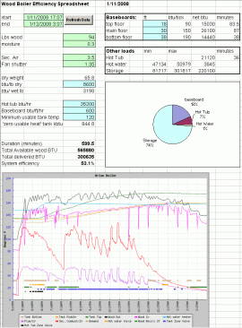

I had a thread earlier that covers this in excruciating detail. Of course, you have to measure moisture content as well as weight, and you have to take detailed measurements of the heat that's produced over the course of a burn.
Bottom line: My system efficiency is about 55% - that is, of all the heat value that's in the wood that I burn, 55% is measurable output delivered to heat loads in my system. The rest is heat leakage from pipes and the boiler itself, or lost up the chimney as water vapor, hot flue gas, and so on.

Nofossil,
I'm glad your on our side. I love how every wood boiler mfr raves about 85-95%.
Any ideas on further performance boosts or are we topped out? I hate to think almost half the wood I burn goes up in smoke even if all is running near perfection.

The devil's in the details. It's a lot easier to get 90% efficiency if you assume that the available energy is 6500 BTU/lb rather than 8600 btu/lb, for instance. Combustion efficiency is different than unit efficiency, which is different than system efficiency. A lot of the heat that I'm not catching in my 56% is heat that still goes into the house, so it's not lost. My actual efficiency would be worse if the unit were in an outbuilding, though.
I've made some improvements to my system that I hope will get me another 5% or so. I just need a couple of loads of consistent wood to do the tests. Haven't had that in a while.

Nofossil - Your graph showing all the temps in your system over time is awesome. I especially appreciate looking at it to get a feel for your heat exchanger performance. I noticed that you need to cycle the storage zone and that during the periods where the zone is on the boiler ouptut temp goes down very quickly. This indicates to me that your heat exchangers are certainly good enough, if not better than they need to be, during that stage of the heating process. However, I would guess that the most demanding part of the process for the HX is at the end when the tank is getting near the boiler output temp, due to the smaller heat delta available to drive the heat transfer. I can see on your graph that the tank temp starts to rise less rapidly near the end as expected, but that it still gets up to temp pretty darn quickly. It looks like there is no need for better heat transfer, which means that your HX should server as a good example for the one i am designing. Granted, you have a different boiler that I will be getting, but I can scale the HX based on boiler BTU. I checked your web site, but you didn't indicate the size tubing for the boiler HX. What size tubing and what total length do you have?
