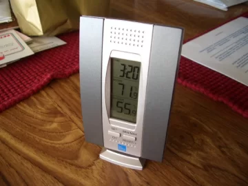

This being our first year with a pellet stove, we are also a bit concerned about the possibility of pipes freezing. It so happens that the pipes I'm most concerned with are located in a crawl space under only a part of the house. So, what I did was purchase a simple remote thermostat at Home Depot (below) for $14.99. It comes with a remote unit (not shown) that I mounted on a 1"x2" suspended in the air in our crawl space which I put where I thought would be the coldest area to be worried about. The receiver sits wherever you want and shows the time of day, the temperature at the receiver and the temperature at the remote unit. This gives me absolute peace of mind knowing that all I have to do is look at it and see what the temperature is under the house, which is at 55° fahrenheit right now, and the outside temperature got down to 31° last night. If I ever notice the temperature getting close to or at freezing, I'll run my furnace intermittently to keep the pipes from freezing.
I had purchased another one of these over a year ago and placed the remote unit for it outside in a shaded area on our porch and it has worked perfectly, and the remote unit still has it's original AA batteries that I put in.

  • [Hearth.com] Will my pipes freeze...
I have a similiar setup with 1 outside and 1 in the kids room, that way I know how cool it is in there for the little guys. Works great!
As I mentioned earlier, I got mine from Home Depot for $14.99 and it works perfectly. It's sold by The Weather Channel.

I have one with 3 channels and I purchased the extras, 1 in my crawl space, 1 outside and 1 in the garage with the water softner. I can sit in my office and check all 3 temperatures. Makes it easy to monitor pipes for freezing possibilities.
