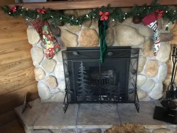

Want to put a pellet stove on the hearth in front of my old ZC fireplace and vent it horizontally through the wood wall to the left.
I imagine I would have to use some sort of elbow to make it work.
The hearth is 18” deep so I imagine I would have to make it deeper.
It’s probably 2’ from the middle of the firebox to the start of the wood wall.
Would this plan work with a manufacturers specifications?
Ty!

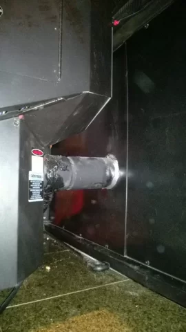

Take a look at my avatar. I did something similar with Mine. I used a 4" stainless chimney liner and top kit and vented it through the regular chimney. You'll have to build an extended hearth to accommodate the minimum floor clearance. I built an aluminum cover for the existing hearth and took out the damper and saved it if I want to put everything back to original. The 4" kit with top, tee, 3" reducer and 3" horizontal to the stove was about $330. After making and installing the hearth it only took 3 hours to finish the complete install including the outside air which I tied into the existing one. Has worked perfectly for 4 1/2 years.

My stainless liner runs all the way to the top of the chimney inside the fireplace flue.

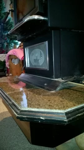

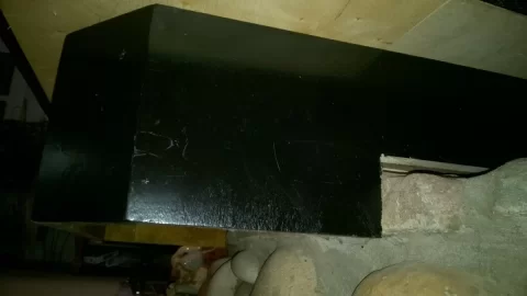

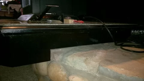

My heart pad is custom built by me out of 3/4 inch plywood with Granite tile on the top. It is structured to sit on top of the fireplace hearth and is bolted down to it so no movement is possible. I'll work on a pic later.

Here are the pics of my hearth you requested.
