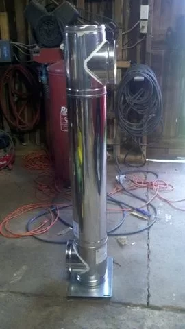

First off, I apologize for all the questions this week but everything i needed for my install came in this week.
In the pic below is the setup for my chimney that i would like to use. The bottom tee will be about 14" below grade in a well lined with
gravel (which was helped here already here on that). I would like to add 36" pc on bottom tee then add a second tee and continue on up.
The reason for this is so i can clean from the ground up and stay off roof which is very steep.
I need to purchase 2 insulated plugs in case leaves get against bottom clean out and so that second tee stays insulated.
Anyone think this is a bad idea or have any other suggestions.
Thanks everyone.

Seems like it should work ok. Will the bottom of the lower tee be somewhat elevated above the gravel?
About 12" between it and the gravel. I hope to build a chase around it next year, running out of time this year. Thinking about somehow making a cover to keep stuff from blowing in and getting close to pipe.
It should work out just fine. I had a setup similar to that at our old house. Keep an eye on the leaves or what have you so they don't build up near the pipe and you'll be ok. You'll be really happy to be able to clean from the ground and not contend with a steep roof pitch, especially in the winter!

That sounds good. You could make a leaf cage out of 1 or 1.5" mesh like chicken wire I would think.
What's your pipe run from the 'T' up to the cap going to be like?
It will be 25 more feet straight up from tee.

Yeah, since your pipe run is nice and straight this looks like it will work out for you well on alot of fronts. I just had my SS liner cleaned from the interior up to the cap for the first time and I have to say this method was much safer and quicker than going up on the roof.
25' should be fine. General rule is to subtract about 3' for each elbow. So 2 elbows mean subtract 6' which leaves you with 19.
I think it's a great idea! I had a very very high roof without one (WV had little building codes). Cleaning from the top of a steep pitch 3 stories up was not fun! I had to scale up the 6 foot chimney while fighting with the chimney sweeper (I have no idea why they extended it so high). I was glad to be out of that house!
