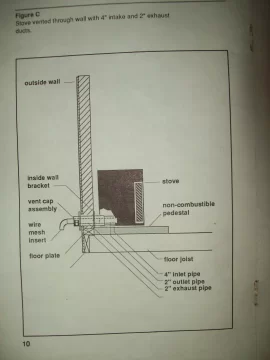

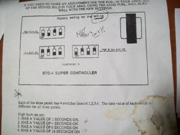

I'm getting inquiries about Winston Pellet Stoves from this site regarding the Owner's Manual, seems I might be one of the few people on God's green earth that has one'd like to get that posted ASAP but I just need to get it scanned so bear with me, it will get done. For right now, here's the fuel feeding specs:
