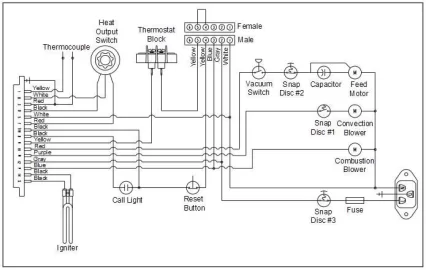

Does anyone have the layout/diagram of the wiring harness that connects into the 4 speed control board? I need to know which one the thermocouple comes in on.
Thanks,
Mike
Is this what you were looking for?
