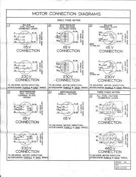

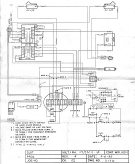

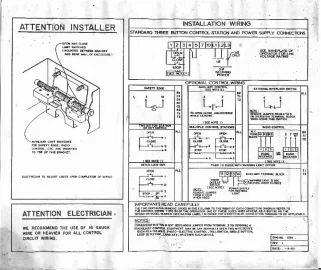

I have a power operated, overhead, commercial garage door. I have attached the wiring diagrams for the door opener mounted on ceiling. I have a remote control that I would like to hook up. The remote has it's own power supply and when I operate remote it breaks the contact. The door is wired with a 3 button control that has STOP, OPEN and CLOSE. With the 3 button control, when the door is moving you can STOP it and reverse direction or it must OPEN all the way and then you can CLOSE it.
When I attach the remote opener to terminals 1 & 2 the closed door will OPEN, and it will go all the way OPEN. When the door is OPEN and I have the remote wired to terminals 1 & 3 it will CLOSE and go all the way CLOSED.
Is there a way to wire the remote to have door OPEN and CLOSE. Is there a way to do it if I remove the STOP, OPEN & CLOSE button and just go with the remote? The remote is just like a regular residential garage door opener with a button that is a controller and it also has a radio remote.
On the second set of diagrams there is some optional terminal strips for wiring a remote. I definitely don't have those. Nor do I have a any wires on # 7 on main strip. I have spent some time on it already and am thinking that I'm either going to need to add something, like a relay or remove the 3 button control and make a corresponding wiring adjustment.
I put a circle around the main terminal strip on page 1.
Thanks for any help up front, Rob

It seems that if I could figure what was suppose to be on the #7 terminal then I could go from 3 & 7 and I have power already. The door stops at each end of cycle by the limit switches in center diagram under Attention Installer.
