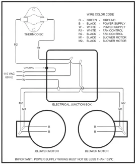

I was thinking this would be where the thermostat wire connects to the switch on the wood furnace, but I was assuming that switch is separate from the fan control switch on the oil furnace. Now, llooking at a Clayton schematic, I see no thermostat connection. Only a snap switch. What switch did the hvac person replace? It could be the wrong one.
Does your system have two zones with each thermostat controlling a separate zone? Post some pictures for verification.
This is the schematic I have for the Clayton 1660
