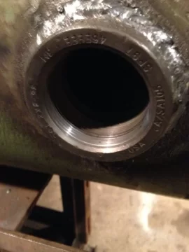

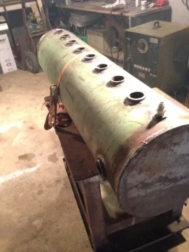

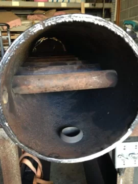

I am making a wood boiler using a 1/2" wall ~400 gal tank for the fire box, and a 4 1/2' x 14" pipe for the water tank. I welded 8 pieces of 2" pipe in the water tank top to bottom, as fire tubes to increase surface area / heat transfer.
My inlet / outlets for the water are 2" threaded, because after I put the tank in the firebox I won't be able to get inside to weld them and check for leaks. I want to use a high temp epoxy to seal the threads because I feel like pipe dope will crack over time.
Any thoughts on a good high temp epoxy 2000+ degrees f ?
Any experience with this ?

If you are counting on a water seal with threaded pipe, pipe dope is good.
Structure holding water not going to get to 2,000 degrees safely. Counting on epoxy to hold something instead of pipe dope probably not built for the long term.
In other words, if you can't count on pipe dope, it better be welded. I build some homemade stuff myself, but glorified glue is not to be trusted with a pressure vessel or long term use of high heat.
Basically I am looking for something to smear on the threads before putting them together, is there some type of hi temp pipe dope?
Are you saying welding it is the only way to ensure a good seal (that is if my welds are good)?
Pressure in the tank will be low, 15 psi +/- But temperature range will be drastic.
Also I was thinking about a cast iron sectional boiler. When they put the sections together they are not welded. Do they use some goop?
I'm not a boiler maker. So for what it is worth, I would avoid a threaded connection inside of a burn chamber.
I can't tell what exactly you have going on in your build. I guess this is low pressure hot water and not steam?
Maybe lookup sealant acceptable for steam, which provides a little overkill for hot water. I also suggest you pressure check before use, otherwise things can and do go wrong.
Hopefully somebody with more experience with reply.
Thanks for the responses.
I have changed the design so the threaded fittings will be outside the firebox.
I think it will also lower my overall labor by a few hours
