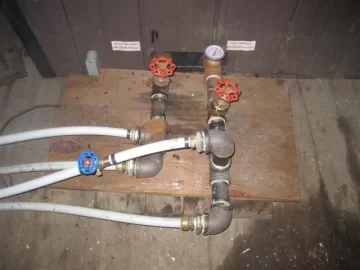

This is my old set up but the water off the bottom off the boiler as per the gauge in picture is 180 degrees and has been as hot as 200 I believe there is a huge safety margin built in the printed 180 on the pex IMHO
