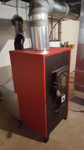

I put my thermometer on the pipe next to the wall. I try to keep it above 250 as any less it turns into creasote range. Ideal would be 250-500. If you walk outside while your burning and the smoke is clear you are in the good range and not producing creasote.
