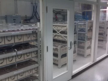

I am in agreement with your charging/draining protocol, I don't have that option as my batteries drain to les than 50% in about 30 seconds!
I wish you were closer, I have C&D Liberty 1000's lying around

Those batteries sound like their function is to keep power to PC's just long enough to shut them down. Alternative energy systems require "true" deep cycle batteries. Other designs wouldn't hack it... for long.
They are set up to carry over 1k amps 'till my gens takeover, 300ah p/unit
