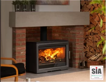

Interesting we hadn't considered free standing. Looking online something like this would be an option, no legs to help with height concern and a large glass opening which is desired for ambiance. Found this on a UK site (https://www.csfireplaces.co.uk/woodburner-stoves-and-fires-gallery/) anyone install a unit like this that you'd recommend?
Also with free standing units, are there any that have optional legs? I'm seeing on Jotul options for shorter legs on some units?

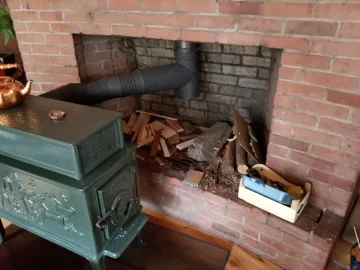

Folks, here is an image of my current setup, the height looks like more than 30, I'm on vacation at the moment so the 30 was from memory, maybe it was 36? I'll measure again when I get home and post if there is any difference.

Take a look at the MF Fire Nova 2.
That looks like a pretty shallow fireplace, so I am not sure there is the depth needed to fit it. We need some accurate measurements.
Would a rear-vented freestanding stove on the floor where the 118 sits work?
Whatever you do you will need quite a bit more hearth as well

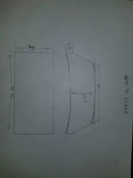

All, finally captured actual dims. Please review attached and if you have further recommendations they would be much appreciated.
  • [Hearth.com] Wood Insert Recommendation
That helps. Looks are deceiving, the camera distorted the depth. There is enough wiggle room as long as the stove fits under the lintel. This will include almost all inserts but few freestanding stoves. The MF Fire Nova 2 is 26.5 high.
