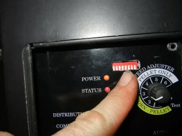

When switching from wood pellets to burning corn you also need to adjust the dip switch controls on the control board along with doing all the changes you have already done. For corn burning switches 3, 7 and 8 should be on while all others are switched off. For wood burning switches 1, 7 and 8 should be on while all the others are switched to off.
what ever that means?? lol ill let you know if i can get anyone to do just that.
Corn is cheap this year but who knows what it will be in the future. I would stick with burning 50/50 mix, unless the switch over is easy to switch back and cheap. This way you can always burn half your stock as corn if the price stays cheap and other half pellets. Who knows what pellets will cost next year. I am guessing that with the cheap price of oil, propane and gas this year, you will find that many our cutting back on the pellets and using their furnaces more. I'll bet that there will be an over stock of pellets this spring and summer which will push the price of pellets back down. Many will have a good portion of their pellet stock left from over buying this season to carry into next season.
you have a good point. thanks
hello all i have a Harman PC45 and burning ''fiber energy products'' wood pellets that came from Arizona i bought from TSC and am not real impressed with them lots of ash and even tar build up. im mixing 1/3 corn and its helping with more heat and less ash. been thinking next year going to just corn but have to have the stove switched diagnostically to do so. even my glass window has build up daily that needs cleaned off from these pellets. whats the negative with strait corn burning ? thanks am new to this bio heat lol

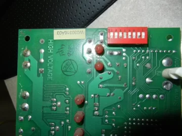

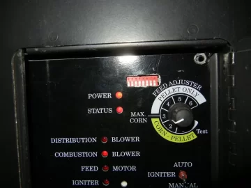

Burning corn in a 45 is easy and you can switch the diagnostics yourself. There is a series of micro switches called "dip switches" covered by that black coating on the control board. Slice it open and using a small screwdriver pry up a small piece of metal covering part of the dip switches. The stoves came with all the switches down or off which is what Harman suggests for corn. Very simple process. You need a special plate that covers the fan. There is two plates available as Bioburner mentioned. You will also be using a agitator that fits onto the auger which will stir the corn in order to get a better burn. Burning corn will give you a new problem as that agitator I mentioned will build up with slag as I call it which will mean you should have two agitators and replace them when ever they get built up with hard crud. I set them in water which will dissolve that crud after a couple hours so you can reuse them when you need them.
Having said that I suggest you try different blends of pellets/corn mixes until you get a mix that will minimize buildup on the agitators. If you run the 45 hard and hot you can expect the agitator to be replaced in one season. That reflective grain cap will also not make two seasons either. But running at a more moderate temp both items will last longer
First 2 pictures are of a older board that burns straight corn and was just pulled for a cleaning. Second two are for the stove I have currently running. Switches are very easy to change with a sharp object like an awl or such. There was a revision of boards in 2010. I have not had good luck with the customer help of late. Seems they now have someone read a manual to tell you how to run a stove and they have no idea probably of what these stoves are other than its a paycheck for them. Next will be customer service from India. Did they ask what age your stove was?

That little stove has been a very high learning curve for me but using for a bit different purpose. The project stove is almost ready to go. Just need a proper cleaning of the board and some testing.
The second set of board pictures I posted are working well in our stove and others burning straight pellets or blending.

the pictures you sent were very helpful thanks so much for all your help!!! Have a Merry Christmas!

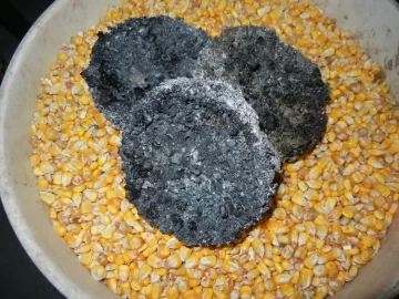

When burning corn (or a mix) and pushing the air volume to achieve a better, hotter burn, something else occurs... Your agitator erodes away, or at least the fingers do. Thats because 3 series stainless in an oxygen rich flame heated, erodes (oxidizes away) so you want to balance the combustion air to agitator life or in a pot type stove, remove the agitator entirely and learn to pull kninkers, which is what I do.
Have a biscuit with your Christmas corn.[Hearth.com] wood pellets or corn?

No. It feeds from above. Why it's a true multifuel. It's potted with an agitator running above the pot stirring the 'mess'. I used to have a bottom feeder but it presents too many issue with corn, least in my opinion, including very frequent cleanings.
The 39's and 41's can run no agitator at all with a corn/clinker pot. I'm running an agitator because I'm mixing pellets and corn. If I was straight corn, I'd switch pots to my clinker pot and pull the stirrer rod entirely.
You can run the OEM pot with straight corn but you must enlarge some of the combustion air holes and be prepared to pulll the clinker daily. With a true clinker pot pulling ther clinker becomes a 3 day interval, possibly longer depending on feed rate..
Again, personally speaking, I prefer a top/drop feeder for corn and or a pusher pot in a corn furnace where the corn is pushed up in the pot from the bottom and the ash/clinker spills over into the ash pan.
