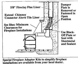

Hi, I am a nubie and looking for some advice on how to do my flue, when I get my wood stove. I am putting it on my fireplace hearth which is brick on conc floor and the fire place is brick and the chimney is brick lined with the tile flue. Has anyone used the method shown in the attached picture over just having a plate that covers the fireplace opening with the flue penetrating that. What are the ups and downs of each method? Any help is appreciated.

There are a few downsides to a "direct connect." When the smoke spills into the larger tile flue, it slows and cools, and it more likely to condense as creosote. As a direct result, you may need to clean the chimney more often. And the chimney has now been made much harder to clean, because your stove and metal liner will need to be removed every time you do it. So it's a double whammy.
Furthermore, if it's an exterior chimney, you will lose more heat than with a full liner, even with a blockoff. And if the tile liner is large, you may have draft problems. What are the dimensions of the current flue, and what stove(s) are you considering?
Along with what branchburner said, your stove manufacturer my not endorse such an install. Local code enforcement and your homeowners insurance company normally defer to manufacturer endorsements. More clearly stated: Normally your local codes won't allow this type of install. Is it done? Yes.

Plain and simple, pay the extra money and enjoy the added safety, better performance and easier to clean stove. No ifs ands or buts. Theres really nothing more to discuss on this.

What size is your fireplace flue? I think it would work fine if your chimney was the same size as your stoves exhaust collar, but most fireplaces are much larger and you would be better off relining the whole system for better draft and easy sweeping.
This is what I did with my heatform fireplace. It had a large 12x12 tile flue and I installed a 6" liner and poured perlite insulation down and behind the new brick block off plate.
