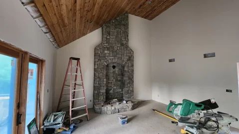

Here's where our stove is going to sit:
![[Hearth.com] Wood stove heat vs LVP [Hearth.com] Wood stove heat vs LVP](https://www.hearth.com/talk/data/attachments/313/313604-46d918b0db68bbf2e9b7d5982ae15378.jpg?hash=FJtnxNOQkZ)
We're using a floating LVP floor in the living room where this stove will sit. My builder says it will be ok, but I'm just trying to confirm and/or look into options. Anyone know if a floor protection buffer like this needs to be measured horizontally only? Or if it's elevated might I be able to factor that in? If the LVP would be a problem here, what sort of flooring is recommended in front of the stove?
![[Hearth.com] Wood stove heat vs LVP [Hearth.com] Wood stove heat vs LVP](https://www.hearth.com/talk/data/attachments/313/313624-2ddb7011f824301184a41a7b1b879c88.jpg?hash=RIkOz64-PG)
