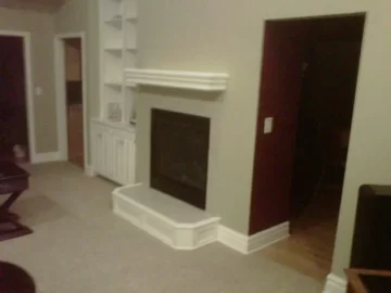

I recently moved to the country north of kansas city. I have 3.5 acres with limited access to wood ( 3-6 cords a year). I have a 1.5 story house with full finished basement totaling 3500 square feet. I currently heat with propane which is about 400 month! I want to supplement that with either a high efficiency wood stove insert or outdoor wood burning boiler to reduce propane costs. I have construction experience and would be able to do most if not all of the installation myself. There is a dual sided gas fireplace centrally located between my kitchen and main living area that we don't use. The main living area has very high cathedral ceilings. Two bedrooms are upstairs connected by a catwalk which are open to the cathedral ceiling. At first I was leaning towards the Outdoor boiler but am concerned about excessive wood use. I believe the location of my current fireplace would be great for a stove insert. I would enclose the kitchen side of the fireplace with drywall if I installed the wood stove insert. Another problem I have is I am on the road traveling about 10 nights a month and can't tend to the fire. My wife agreed to take care of firing up while I am gone but I am not sure how well that will work with the OWB. I want to be able to have the fire burning while we are at work. Can the wood stove insert burn safely unattended? Anyone have any suggestions as to why I should lean towards one heating method or another? I have attached a picture of the living room side of my fireplace and a picture looking upstairs from the living room. I realize this is the fireplace forum so I might get biased opinions.

Welcome. Is this a prefab gas fireplace or a masonry fireplace with gas logs? A wood insert can not be installed in the gas fireplace. If that is the case, in order to have a wood burner in that location, the gas fireplace would need complete removal, flue included. If you have construction experience, this is doable with some work. Then you need to decide what to put in, a freestanding stove or a high-efficiency wood fireplace.
It is a prefab gas fireplace. I realize it will need to be completely removed and rebuilt so to speak. I think a high efficiency fireplace would be the way to go cause I don't know how a free standing would have enough room with the wall there. This is a dual sided prefab so the other side would have to be enclosed unless they make a dual sided wood burner.
