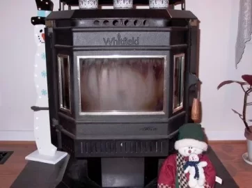

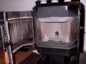

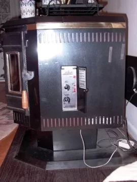

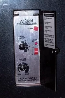

My house came w/ a fireplace insert downstairs and a pellet stove upstairs. I use the wood stove all winter long; it's great. Never used pellet stove. I want to expand upstairs and have "a" stove in the new area to more effectively heat upstairs. Pellet stove is Whitfield, Serial # WH 24328; I don't know what model.
Questions:
(1) How can I determine model # from the serial #, if possible? How can I determine fair market value of it? It's in terrific shape, see pictures. I have an opportunity to trade for a Vermont Castings Wood Stove.

What you have there is a Whitfield WP-2 Advatage IIT, a 42,000 btu heater. This should be a great unit to use as a supplement heat source. Looks as if it could use a thorough service/cleaning. When comparing wood to pellet as far as convenience goes, pellet is certainly cleaner and easier, however both require maintenance - morso with the pellet as it has more moving parts. Cost to operate can vary depending on your needs/wants and preference, but theirs been excellent discussion on this subject in this forum. Value of this stove is a liitle hard to determine, but I always figure anything used is only worth what someone's willing to pay for it. As a example, I just purchased one of these used from a customer of mine that switched over to propane heat. I paid $500 for it and will recondition it for resale and it will be worth around $1500-$1650 depending on what all I replace/repair. I think that you'd be happy either way, what it boils down to is preference.
