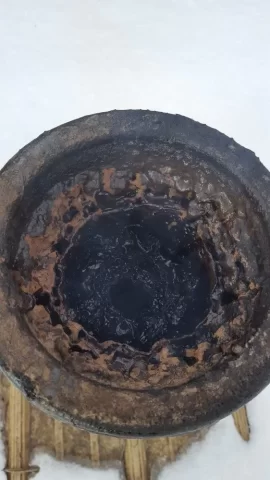

Well I believe I found the problem. Got on top of the roof with a chimney brush and when I looked down the 6" pipe I saw this, it was restricted to about an inch! It was hard to get it all out but it is completely clean and breathing great now. Stopped smoke from weeping from the damper doorand when I close the door the fan no longer sounds like it is fighting some dark force. Hoping that was it, if not, not sure what else it could be, I'll let you know if this fixed my issues.

You must have had a lot of smoldering going on to create that - suspecting most of it happened in warmer weather periods when it was idling.
At least you have more of a handle on it - good luck going forward.
