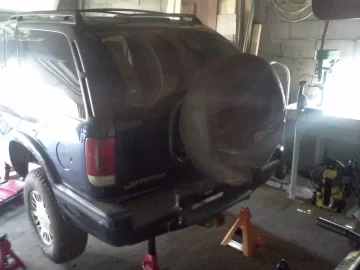

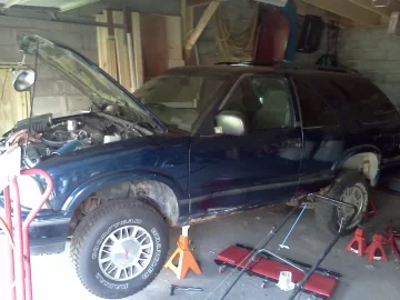

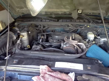

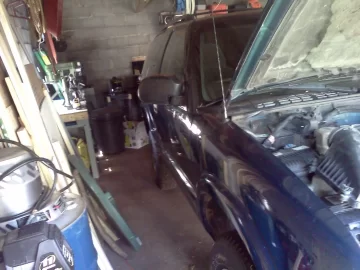

Ok finally got round to taking pictures of the jimmy. I have been working mostly on the bottom side cleaning out the transmission and oil pans. The oil was so thick it looked like molasses ! I degreased the engine compartment and washed the heck out of it because it sat for 1.5 years and got all kinds of dirt and surface corrosion on it as well. The real kicker so far is that the trans was out of fluid as was the rear differential. I am guessing that was why the trans was not working ;lol it runs good now. The rest is mainly cosmetic aside from leaf springs and shocks !
Pete
