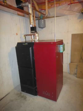

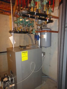

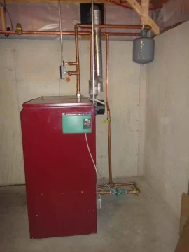

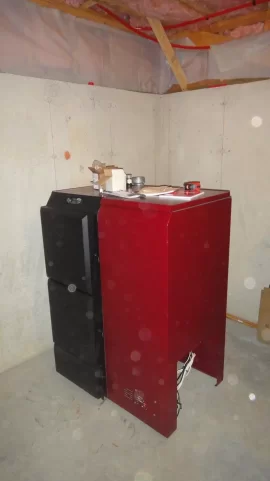

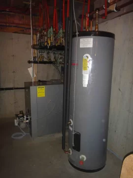

Our customer just finished his installation of a WP100 pellet boiler with 350 Lbs pellet hopper.
It's hooked into an exisiting oil burner setup.
Before the thermostat was set at 62F.
Now they are not affraid any longer to keep the house at 70F.
And the 70F with wood pellets is at less then half the cost of oil.

Sweet. How long will a 350lb hopper keep them warm? How much are they heating with it? Thanks for sharing the pics and story.
350 Lb hopper is just shy of 9 bags.
The last 4 weeks, on average 2 bags per day.
The house is around 5,000 SF and very well insulated and tight.
More ashes then expected. Need to vacuum clean the bottom ash compartment once a week.
Wood pellets have a lot of fines in it. Will post a picture of the wood pellets.
Will switch to other brand of wood pellets to compare.
Not all homeowners are good at weekly maintenance like that. I'd do it in a heartbeat.. but I don't have any pellet trees. :)
Still.. I always love the idea of people spending money that STAYS local. This is a way better solution than oil. I assume the boiler will just shut down on fault if it isn't cleaned proper?

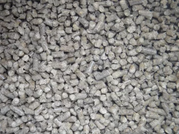

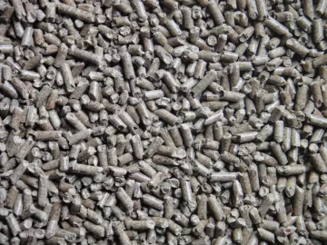

Below a picture of the wood pellets fuel used with this WP100.
Most of the pellets are 1/4" long. There are also a lot of fines and saw dust.
The other picture is another brand of wood pellets. They are on average 1/2" long and almost no fines.
Both have the "super premium wood pellets" labeling from PFI on the bags.

Pellets make a huge difference.

Marc, if I understand correctly, the PFI rating only refers to ash content? Not sure about durability, fines, etc.
That's correct.
BUT: not many wood pellet mills do continuos monitoring of all the parameters by 3rd party testing agencies.
Maybe once or twice a year, and this is not enough.
It's very "misleading information" what's on the plastic bags containing the wood pellets
The 1/4" long wood pellets are fine. They fall in the burner pot where they belong and where they get burned.
It's the fines and saw dust that don;t have a chance to get burned and just fall down by gravity, some in the burner pot, but most of it outside the burner pot and in the as tray.
It took me several weeks to come to a conclusion and this only after talking to prominent players in the wood pellet business.
The wood pellets should be treated as any other fuel and regulations/oversight are needed, just like for gasoline, heating oil, .... .
If not, consumers will pay the bill and the "wood burning" industry will, once again, shoot itself in the foot.
