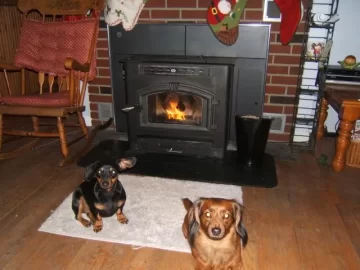

Here is a picture of mine. US Stove 6039. You don't have to have an insert either. I believe there are a few folks here who have installed a freestanding and ran the exhaust out their existing chimney. Ranger, I believe had a very nice setup like that.
