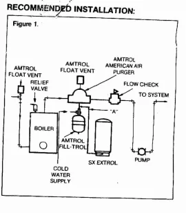

I have a well xtroll tank model 252 that is rated up to 200 degrees with 86 gallon capacity. I was hoping that would be big enough. I know there are some guys with 1000 gallon tanks that are useing 86 gallon expansion tanks. It would save me some money if I could use that one.
Brian
I don't think the tank will be big enough. The 252 is rated at 86 gal with a 0.39 acceptance factor, or 33 gal. Water from 32-200 has an expansion factor of I think a little more than 3.5%, and I tend to use 5% as a safety factor, which means a 0 pressure expansion of 75 gal, which is more than twice your acceptance volume. Under pressure the expansion factor needs to be greater. In all events your tank is too small, probably need two of them at a minimum.
Another one shouldn't be a problem. Is there a speacil way I should consider hooking them up togather ?
Just in parallel - see attachment for general diagram.
