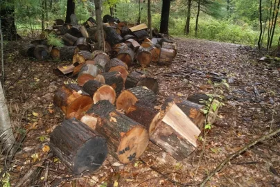

    i'm estimating that i'm done cutting for 2014/15. the pile of rounds here is about 5 cords. couple that with many many rounds of white pine and i'm good to go for shoulder season wood too. i guess i could keep cutting hardwood but i want to get this pile split after hunting season so i can stack it in the spring and give it 2 summers to cook.
