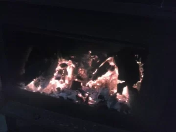

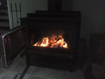

    Sorry my mistake the colour of the thermometer is white and the temp was 400. :(
    Got home last night at 5:15 pm so the fire was left for over 9 hrs and i came home to a warm house with plenty of coals. The window looks a little 'coloured' but a quick hot fire soon sorted that. Not sure how much wood i will use but it takes 2 full armful's to fill her up but it is still better than trying to light the fire every day. Just means i need more wood ==c
