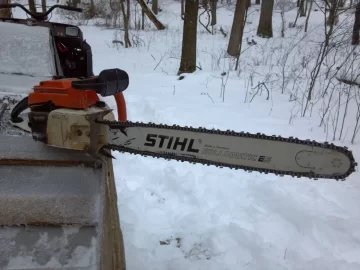

    Well today was the day, scored a partial downed oak enough to fill the dually and broke out the new saw. Second pull and she fired. I didn't know what to think as it sounded like a kitten compared to my defunct 041 super. Yes it a great saw going thru the 20" plus oak but really miss that roar of the 041. So should I go for the dual port muffler or leave it stock? As a side note used my 280 for some of the smaller branchs and not to much difference noise wise.

    I love my 041 Supers.....both of them! And I fabbed dual-ported the mufflers on them too. As MM said, the dual port would be an awesome sound and performance upgrade on that 460.......
    I also forged those bucking spikes on that saw, out of a Jeep leaf spring! Those puppies are MEGA strong!

    Thanks Boog! I'm gonna make more of them when I get my forge up and running. I made these ones on my buddy's forge. Wasn't too hard to make them, but I had to get them hot to drill the mounting holes and temper them after the holes were in. They give the saw a mean look and are also really nice in thick bark trees. Nothing like a good west coast-style spike!
