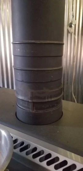

I can get the same brand duravent but i can only find one in that brand thats at its longest 46 inches i need 51 and a half to the stove Collar. To the stove adapter i need 50 inches you can look at the pic i think i used 2 stove pipe adapter to make my single wall work
Heres the picture
Dura-vent makes a longer slip kit.

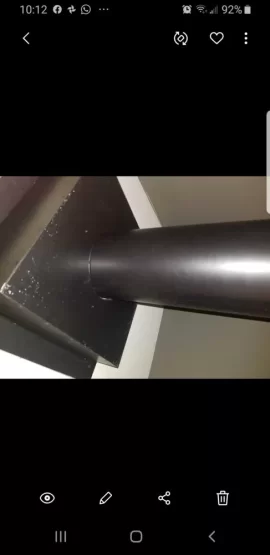

I thought the single wall pipe hooked right to the ceiling support box i cant recall a adapter up there but my memory isn't the best.would i have to take the single wall down to see the adapter are should I be able to tell without taking the single wall down.if it came in the kit i am sure i used it i guess
