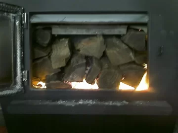

So, the inside of the firebox on a BKK is 24" wide x 15" high and you can load 18" splits in it. However, you can load the firebox all the way up every time. Not sure how this compares to your 6 good size pieces. The bigger question though is how much of this potential heat ends up in your house versus your neighborhood. If I load 24" wide x 15" high x 18" deep with good dry hardwood, I don't get less than a 12 hour burn burning wide open. I heated 2000 sq ft on a windy upstate NY ridge last winter and I am in the middle of a major remodel with no backup heat. No siding, no drywall, and a wall of windows held in with 4 screws and fiberglass stuffed around them. Just went through 8 or 9 cord doing it. This is a typical load when its cold and blowing out.

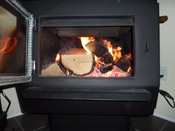

It looks like you are stacking them in tighter than me. As for the heating the outside thing, I've mentioned this before, and I don't understand it myself, but with a stove top temp 500-600 degrees I can rest my hand on the stove pipe momentarily 2 feet above the stove and the temp on the pipe will only be about 150 degrees. I do have good draft (35' chimney) but I'm figuring the 8"-6" adapter is acting like a damper trapping the heat in the stove.
You don't normally have to pack the stove like that. I normally just put 3-4 splits which is about 75% full. Keep in mind I have the Princess as well so my stove packed right full would be maybe a 1/2 load in the King?
I find with it packed all the way full the sides don't burn all that well and when I go to reload I have to pull those in the middle. Without packing it full it seems to burn the full load.
I just took this pic, had just loaded the stove for the night about 5 mins prior. What I have in there will leave plenty of coals when I get home in the morning around 9AM... ~14hrs from now.

All depends on how you want to do it. If I loaded 75% of what I do now, I would have to load the stove a third more times per season.
14 hours is DAMN good, 'cause I know there ain't no hardwoods in that stove. I'm guessing either birch or spruce.
