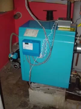

We have a Tekmar 260 for a little over a year now. It runs great with our Buderus G115WS/4 Cast Iron Oil FHW Boiler that is a Triple Pass, Cold start boiler
What Make and Model boiler do you have?
