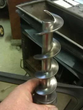

i have been burning my new-to-me 2006 Accentra insert for a couple of weeks now and it has been working great. But last night it started to make a faint but definitely audible noise intermittently when the auger feeds. It's kind of a whistling or squealing sound, almost like if the wind were howling outside in the distance. It doesn't happen all the time that the auger is feeding, just intermittently. Has anyone experienced this, and if so is there a fix? I'm hoping that maybe it will go away after I shut the stove down later today and let it cool down.
Harmans are known for a tight auger and if any carbon buildup it will squeal. Get out a fat blade screwdriver and scrape out the auger tube and hopefully will solve the problem.
Try the stove temp mode for about a half hour on a HIGH heat setting. This will most likely stop the squealing. Let us know if it worked.
One other solution: if you haven't done this recently is to clean and vacuum out the fines box. Not really sure why that works, but it did for me once.
keep it clean
  • Accentra insert auger noise?
Mine does this from time to time - carbon build-up near the end of the auger is the culprit. I find it happens when I burn the stove at lower settings. Solutions? 1. a good cleaning of the problem area; 2. burn the stove on high temp to burn off the carbon (as suggested above); 3. change up your pellets. I found that Eastern Embers were more problematic; Trebios seem to burn without causing this problem. I won't burn Eastern Embers because of this issue.
If all else fails, mix some graphite powder with a handful of pellets and run them through. This will lubricate the auger.
Thanks for the suggestions, I did a hot burn and tried to scrape the opening area of the auger tube and the noise seems to have gone away. After doing some more research on this forum I see that this is a fairly common issue with Harman stoves. Seems like carbon build up is the most common cause, along with fines build up in the hopper chute and fines collection box. One guy claims the problem can be permanently fixed by removing the auger and adding some spot welds to better fasten the spiral to the shaft, thereby preventing the harmonic vibrations that cause these noises. Maybe I'll try it next spring.
