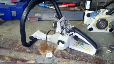

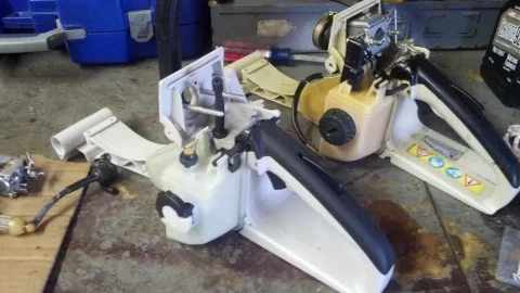

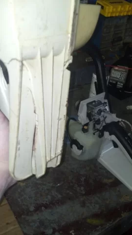

    I cracked my stock handle on one of my 036's, and because I was already in the process of rebuilding it? I decided to put a new Tank/Handle on it.
    Surprisingly, it is a very nice fit and finish. It came with a "Flippy" cap, so the saw will be a "Hybrid". As an 036 should not have Flippies :) Comes with a new fuel line, filter, and cap (which separately, would be about half the cost of the handle).
    Here are a couple pics. The rebuild is just waiting on the New Cylinder and Piston (aftermarket also, but Nikisal plated). With a new air filter, impulse line, fuel line, fuel filter, handle/tank, cylinder, piston/ring, pull cord, spark plug, and a couple other little nic nacs, it will be damn near New Again :) I even put the Factory stickers on the Aftermarket, to make it look Legit.
    Will be ready for "Sale"... The new owner will hopefully be a happy man..
    Don't know how many have thought about buying the cheaper aftermarket version, and not done it? But everything went together like clockwork :) Full review once saw is together and running :cool:

    Looks nice Dex, glad to hear the aftermarket handle fits. I thought about putting one of those on my pimped out 036 "Pro" beater, but I was afraid it would look too pretty to "beat" any more and I'd have to park it on the shelf with the other gems in storage and switch to using something else. :p Why are you going to sell it after doing all this work on it? Looks like your saw inventory is getting dangerously low already............... I have a deep suspicion that a brand new "modern" saw will be heading your way soon!

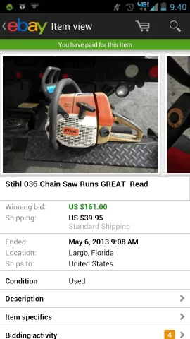

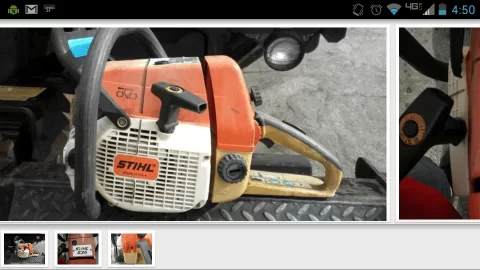

    Speaking of getting low on saws Boog!! I just won an auction for a..... 036 (another one?!?!) ;)
    Yep. Buyer says it runs and will give it a 14 day guarantee to check it over.
    I may be buying another one of these rear handles for this one. I already have a new fuel filter, air filter, impulse and fuel line for this saw.

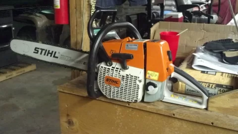

    Just to finish this thread up. Here is the saw finished.
    It ended up in the hands of Big Donnie Brasco (forum member).
    Turned out pretty nice. Overall fit and finish was awesome. Everything lined up and fit perfect.
    The only downfall (not really) is that it has one old school oil cap and a new floppy cap. So anyone who knows saw, will know its not original. It's a Hybrid of sorts ;) I didn't like flippies at 1st, but they are growing on me ;em
