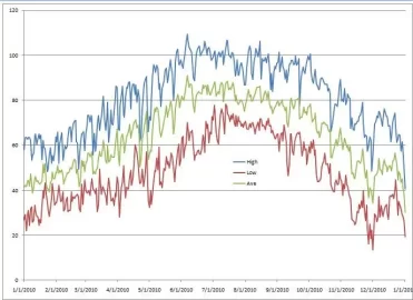

    Lived in AZ for five years. That's a tough one. Your burn season is really short in comparison to nearly everyone else. The 5700 should be plenty since you will not have the prolonged cold build up. Are you in the elevated area near/around Tucson?

    I'm east of Tucson, right at 3,000 feet. If I can make it work, here's a graph of the highs, lows & averages in my parts. . . Some of you are going to get a good laugh from this no doubt, and tell me I need to find an AC forum to hang out in!!

    When night time temps get down in the 40s, it's stove time here. You don't see that often, I'd guess.

    I think any decent size stove would work in this case as he is not dealing with prolong cold temperatures and it would be rare to burn 24/7. With day time temps above 40 and sunny (not the gray cloudy winters most of us are used to) I would just go with a simple secondary burn stove.
