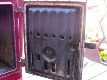

peakbagger said:They are great little stoves, that unfortunately didnt get used properly by many folks and occasionally got a bad rep. Not sure if they are certified which may be a issue depending upon your inspector. They are not an "all nighter", they are ideal to warm up a small area and be fed wood occasionally rather then cramming full and then shutting the damper down low. There are internal heat baffles that need to be in good shape for an efficient burn. The baffles do wear out, but frequently they are broken by someone trying to force over sized wood into the fire box. A great little stove to burn up short lengths of wood. Note that most folks cut their firewood too long to fit the firebox.

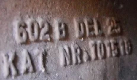

There were a couple of foreign knockoffs of these stove complete with Jotul casting marks. Jotul makes a good casting, so if the casting quality looks poor, be careful as the knockoffs tended to split on occasion.

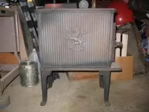

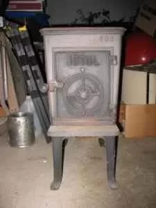

BrowningBAR said:Came across this stove. Trying to find a solution to the kitchen fireplace. It would fit but if anyone has any info out there I would love to hear it.

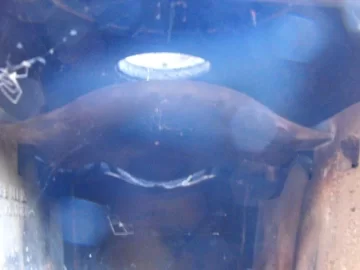

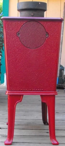

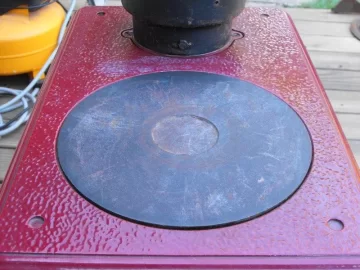

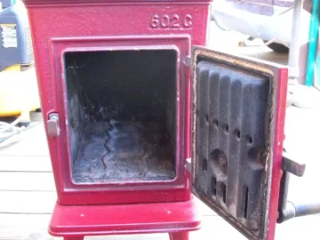

BeGreen said:That said, there appears to be some warning signs of high heat in the stove pictures. The light grey exterior splotchiness may be a sign of failed or missing interior liners. Maybe not, it would take some close examination of key areas to be sure.
journey said:Oh its red without question! I havent seen the stove in person yet, but I will take a look at the back of the stove for cracks, thanks for the explanation. Makes sense if the plate was too far forward. So the plates just slide front to back within the stove body? Is there an obvious "seat" towards the back?
