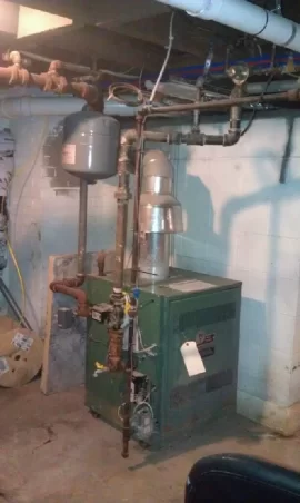

This is the old furnace setup. Monoflow system. You can see expansion tank and 1 pump. I have CI Radiators. Any suggestions on exactly how to hook up new furnace, such as what parts I might need. I am not doing thermal storage this season.......I am going to install it next spring.

You will need some type of return protection with a monoflow system with relitively large water volume.
Are you venting this through a masonry chimney, one shared with the gas boiler?
I have no expierence with other boilers and idleing, but I can tell you the Attack does not idle well for very long. I would NOT recommend useing it w/o some type of storage.
Do you have some good dry wood for the winter stacked up yet? Preforably two year seasoned stuff, I discovered for the first 5 or so burns you need really dry wood to dry out the lower refractory, as others have all expierenced as well.
