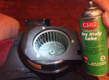

I just tried coating the Astoria blowers with dry moly spray this year to prevent buildup.
See my video here. :) Good Luck.
https://www.hearth.com/talk/threads...on-blower-impellers-to-prevent-buildup.91664/
