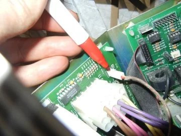

TAke a good look at the board and track down the exhaust temp probe wire to the back of the board. It has a very small clip to connect it to the board and has been a nightmare for many and me but with a faster outcome. It will work loose and then the stove thinks no heat so wants to shut things down. I would like to post a picture but its a pretty hard place to photo well. Like the Harman the exhaust sensor is pretty important to manage the stove. Tip on keeping the stove auto clean feature running smoothly I have found is to dust the plates and burn pot surfaces with powdered graphite.

I have messed around with that wire also, when I put it back into the stove, how far should it go into the hole? It doesn't seem to be bad tried pulling it out while the stove was lite and the room fan slowed down so I assume it is functioning. It's kinda frustrating, revealed the square door on the fan as the gasket was looking bad and seeing if that makes a difference. Is there anyone that I could talk to that knows these stoves?
I was trying to get you to go to where the wire hooks to the board. If the probe is in the stream it should work but because that wire it so stiff it works out of its socket and becomes loose and gives so much grief.

As bioburner suggests, check that the thermocouple wire is snug on the board. Been there, done that. It slips off easily. fyi the thermocouple wire should have a US flag sticker on it.

That thermal wire should be about a inch into the hole but your problem is on the other end where it connects onto the board, As others have said you can bend this wire so it applies pressure to the connection.
