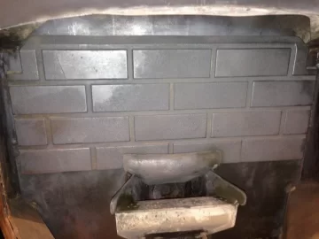

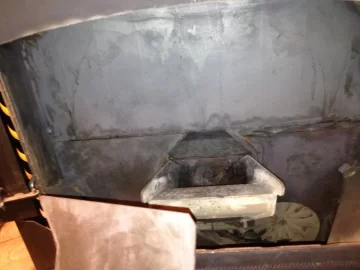

    This old Harman does not have the removable panel to clean the chambers behind the fire brick like the newer models. Naturally, the dryer vent brush was used first to poke up in each accordion tube but to get all the ash out, I used 150 PSI of compressed air.
    See video
    http://www.youtube.com/watch?feature=player_detailpage&v=FCwc-L40ILQ
    Then, with the wire wheel, I cleaned and then coated the fire brick and panels underneath with the Dry Moly Spray. Now they look better and are really slick. Many people do not have the time to paint the fire brick so this seems like a good protective solution.
    Has anyone tried the Dry Moly on their panels and fire brick?

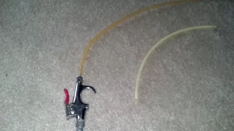

    My eyes! My eyes! May I suggest a feature for your compressor? Use a compression fitting to a 1/4" copper waterline for a flexible long wand so you don't have to get yer hands and face so close to the action.

    I use a 9" piece of brake tubing, the fitting matches my air gun. It's not flexible, though.

    Yeah. Or plastic? I have a couple different lengths for my air nozzle.

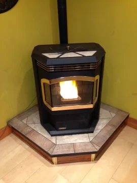

    Leafblowers may not be the answer to ALL. But for those that can? It sucks MUCH more than a standard shop vac and ensures all ash goes out the vent.
    That ash explosion in Dons vid, wouldn't have went over well here :(

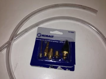

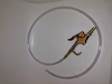

    Thanks Dexter, I picked up a 3 foot piece of 3/8 OD 1/4 ID clear vinly tubing from Lowe's plus a compressor Inflation Kit.
    Both for $3.95 ! ! By using 2 pieces:
    The screw in adapter and the screw on barb, it attaches to the vinyl tubing and works great! ! !
