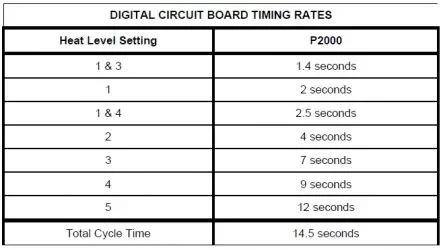

You can trouble shoot the circuit board by verifying these times. thank jtakeman.
  • Breckwell P24I Slow to Light
