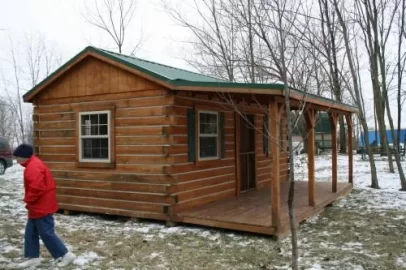

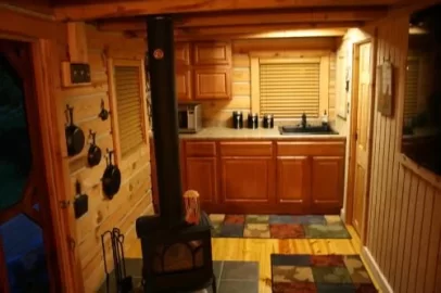

hey dave, really like your "tiny" cabin. was that a prefab or did you build it. the interior is nice and the stove fits it. my little jotul also exits from the top....straight up....took up less space that way. probably would have installed my little 602 that i still have except it was end loading thus sticking out further than my wife really wanted it to. gotta love those jotuls.
cass

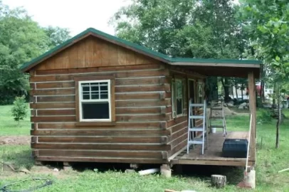

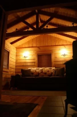

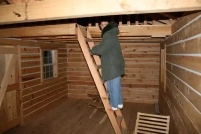

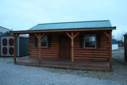

My "log cabin" is a 10' x 20' Mini Barn that was hauled in with an overwide permit and dropped like a dumpster. We finished it, it came as a shell with a partial low loft in one end. We replaced our old 28' travel trailer at our family campground with the cabin. Travel trailers aren't made to sit outside all winter long without taking a toll on them. When it was clear that we weren't taking the trailer on the road as much, we got the cabin and a 12' long Lance 1161 truck camper for the 3 or 4 weekends that we camp away from our main campground.
We have had the cabin about 3 years and just got it "finished" last summer, if it ever really gets finished. The F100 has been installed and operational since the fall of 2010. We really like it, it is about 4 times more stove than we really need once up to temp, but it helps to have more stove than you need while heating up the 6" thick log walls.
I really like the Jotul F100, but it is a small stove. Cutting firewood at 15" takes some getting used to. In order to get 5 to 6 hours and still have enough good coals to reload without starting over we need to load with some well seasoned black locust. More realistic burn time with significant heat output would be closer to 3 1/2 hours or so per load. Fortunately, once the cabin is up to temp, we don't need much output or we are opening some windows for relief.
