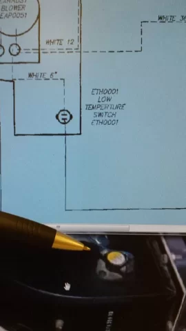

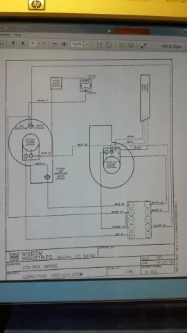

I have owned a Golden Grain Corn Stove Model 1101 for the past 6 years. It has been a great stove and have never had any problems with it until this year. After doing a good cleaning I started the stove and the auger wasn't turning. My son was able to find the part to fix that on ebay, so now that is working. But now the room blower will not come on. We have been trying to find a Room Blower thermal switch and haven't had any luck. Does anybody ave any idea where I can find one? I have all my corn and pellets stocked up, it's supposed to get cold next week and I really would like my dependable heating source back up and running. Thanks for any help you can give me.
Give us a picture of the part. Lot of stoves use the same parts and I would bet that your part is a snap switch, probably around 130F or so. Might well be able to go to a local stove dealer and get the part. Grainger has several stores around MN so that is another source. Just bring in the part.
Welcome
Reactions: Mt Bob
I wouldn't let a faulty snap cap keep you from using stove. Jump across the two leads to keep blower running while you search for a replacement part. It looks like a flush mount snap cap per my picture.
In the manual it's a 110F device (item ETH0001). Do a internet search for the part marked on it, bet you find something easily.

Problem I see with a simple jump is that they are using it as a safety if that is the one I see in the picture on the exhaust fan.
Right or wrong, if folks are isolating are parts, i just assume things are done safely. My advice should always include a disclaimer (take with a grain of salt).
