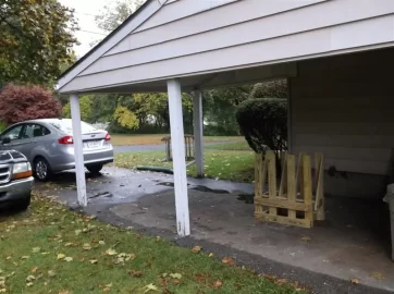

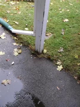

Well come to find out, the genius who built the carport set the 4 x 6 posts (non PT) on top of the dirt, no footing, no attachment at the top of the post:rolleyes:. Posts are starting to rot on the bottom and carport has settled some. ( big surprise)

Sounds like you're on the right track. Fine Homebuilding is a great technical resource. A few thoughts:
The diameter of the footing is dependent upon applied load and the load bearing capacity of the soil. I'd suggest you consult a local building inspector to determine what's commonly done in your area.
The footer at 10" diam. and 48" deep will be relatively heavy which is a good thing. Concrete weighs about 150 lb per cubic ft.
I'm unclear on how you intend to attach the posts to the carport beams but a proper tie in using metal hardware (e.g. hurricane clips) or other means is required to prevent uplift in high winds. (I'm assuming you're planning on replacing the whole post here).
As shown in the video you linked to I'd bring the concrete above grade a bit to keep the hardware dry and to have your line trimmer beating on concrete not post.
Don't underestimate how corrosive the ACQ treated lumber can be. Use hot dipped galvanized or SS fasteners. I believe Simpson requires you use their fasteners or equivalent ones to meet performance specs. Don't assume you can use screws instead of the approved nails and meet specs.
Digging 48" can be tough. Contracting someone to install augered anchors is an option. I don't know the cost but its generally less disruptive than what you're planning with the digging.
Its unclear how your carport is built. If racking is a possibility you may want to install some diagonal braces between posts and beams to prevent it.
