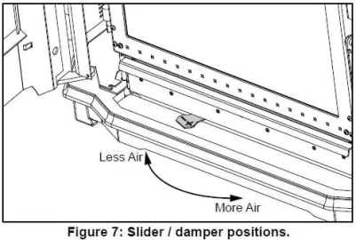

    Where is the ceramic snap disc located? Can you post a picture of it?
    Also, alot of black build up means an over rich mixture just like a car. So in the case of a pellet stove it means there is not enough air going through the burn pot. Can you open the damper more?

    Hi;
    It is located right next to the exhaust blower. It is actually just above the exhaust blower fan. I can slide the damper to add more air also.

    It sounds like it is in the normal place so you just may need more burn air.
