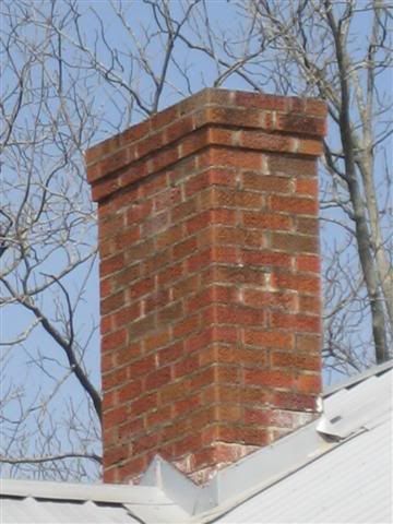

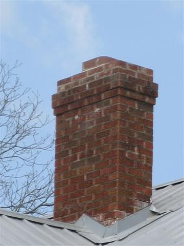

    Today is a great day!!! I finally have a mason here doing the chimney work. He has taken off the top two runs of brick to widen out the mouth of the chimney and has gone for mortar, sand, and bricks. He's going to top it with a 13"x13" flue tile. I'll post some pictures later. Finally getting some good progress going on getting the stove installed. Been a trip so far!!! :)

    BG, the liner isn't in yet. The chimney top was too small to get the liner down. it was a 9+" x 10" flue going up *until* you get to the crown...then it was choked way down. He's opening it up to roughly a 10"x10" opening with a 13"x13" flue tile mounted on the peek. Basically he's taken out two runs of brick to where the old "flue" opened up wider...he has the tile in place and is replacing two runs of bricks now. I'll be capping it with a hinged square chimney cap from chimney liner depot. The guy doing it is the guy wanted to do it all along...the mason that didn't show was kind of a "I'll settle for him guy". This guy will/is doing it right....good reputation.
