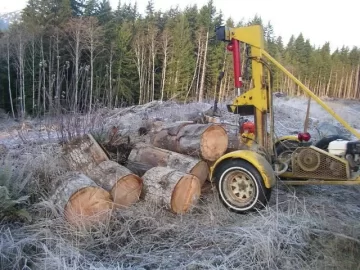

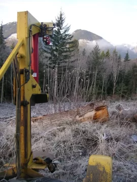

    Likewise our splitter has no suspension, just a solid axle with 15 inch tires with 7 PSI air pressure. Down side is that at that low air pressure you also need tubes in the tires.
    Magnet attaching turn signal brake lights.
    The torsion suspension sounds like an interesting idea!

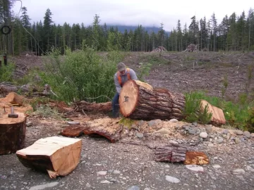

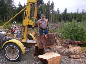

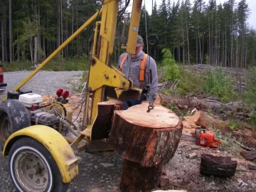

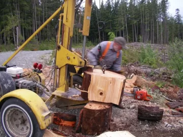

  24. You are right the rims are not designed for low pressure. I very seldom have to go more than a half hour on the highway so heat and friction with tubes is not a factor ,and only collect firewood in the cooler months ,with fire hazard being the biggest reason. Low pressure tubeless tires would sometimes roll off the the bead when yarding bigger blocks that are not in lead .
