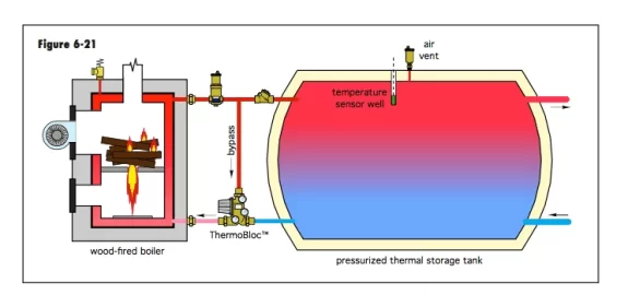

  • circ sizing for 1000gallon storage
I have a 60kw boiler.. 250k BTU. I use a Taco 0011.. which runs about 25gpm with my 1.5 inch piping to storage. It's a very short run, maybe 25 feet of pipe one way.
Just as a WAG. you really should do the head calculations and get the right pump. The boiler won't do you any good if you can't get the heat out of it into your storage.
