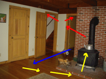

    I can testify to the effects of using a fan to move air around. It helps. The photo shows air circulation path in my stove room. Cold air is blown in from adjacent room (blue arrow) with box fan. Air then turns counterclockwise and rises in warmer part of room (yellow). Above the stove the air is moving to the left. Air exits room out the top of both doors (red arrows). Warm air gets pushed out of the room because cold air is being forced in. In the morning I close the doors and get the room to 75-80F. Then open doors and get convection going. The air going out door to left helps drive a convective loop through first floor as well. Start of loop is door on left. End is at fan in room on right.
