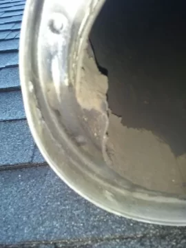

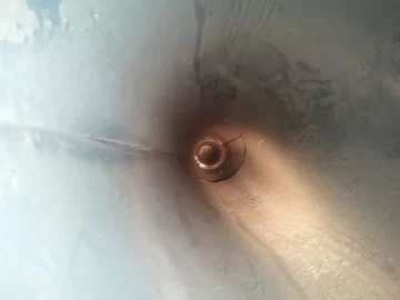

Had a sweep come out today to inspect the flue. The pipe was clean even after three full seasons of burning - thanks mostly to this site. However, he noticed and took pictures of the inner wall of the class A pipe "pealing" back and exposing the insulation layer. It's happening on the two sections we have. I believe it's secure-temp pipe. The sweep says it looks like something that happened during installation. This is based on the fact that a brush has never been through the chimney. The real kicker is that he said I shouldn't use the stove. I'm hoping to get at least a second opinion if not more. Here are the picks.

Did you install this or did you hire someone? If it was hired out, did you call the installer yet?
If there is any question, I agree with the sweep not to burn.

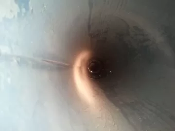

Here's anther pic.

mhrischuk said:
Is that only at the very top?
The pick with the shingles is from the bottom of the top section looking up.
The other pic is looking down into the flue. You can notice "pealing" at the bottom of that section.
I agree with the sweep. That's not good. This is a defect in materials or workmanship. Security should replace the pipe or reimburse for its replacement.
